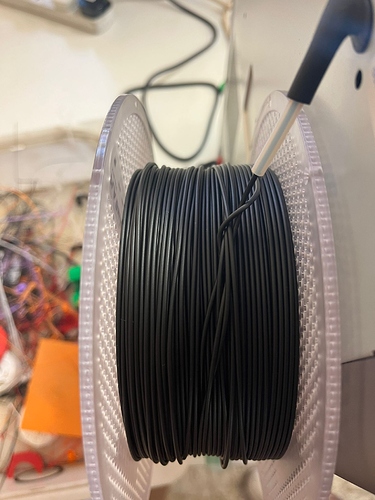

Hey everyone,
Just something to be aware of, I don’t know if the spool that is on the Bambu fell on the floor and was manually re-rolled but some of the filament was tangled. I noticed it near the end of the print when there was a pretty big noise (likely from the extruder pulling on it and it suddenly giving).
Watch out for the good care of the spools as well. Other than that, the printer is great :ok_hand:
@3dtechs FYI
What i do if i notice this before it happens.
I just cut the filament fix the spool and feed it manually till the extruder catches the filament.
Worst case it’s going to trigger the runout sensor. and you just reload it. :smiley:
Yeah I used the manual control of the extruder to pull the filament out, then untwisted the spool and started it again. :ok_hand:
