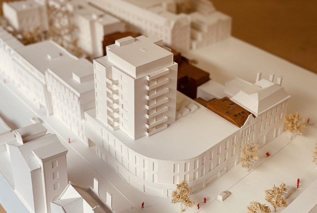

Never made an architectural model myself, but one of my friends made one out of white acrylic or possibly styrene for part of her final year civil engineering project and it looked absolutely beautiful
This is just a random picture I got off Google but it gets the idea across, super clean and neat
thank you - yes that looks great and is the kind of thing I have in mind (albeit simpler). That finish is why I’m not sure about using ply as it seems it would be quite a lot of work to get it to that look. Maybe acrylic is an option then. Thanks again
