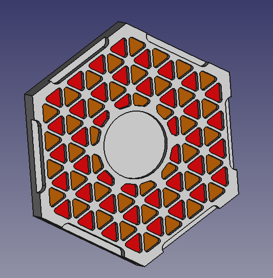

Each hexagon piece will have a pocket in the middle to receive a round laser-cut wooden number token, and pockets on the edges to hold road pieces. I plan on filling in the rounded triangles with enamel paints to create the resource markings. Here’s a screenshot of my most recent design, using a brick piece as an example:

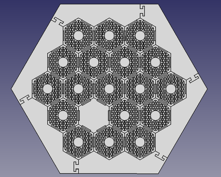

Here’s what a finished board might look like:
In all, I’m going to need 18 of the patterned hexagonal pieces, and 1 unpatterned blank. I’ve worked it so 3 of the hexagons could fit at a time on a blank in the working space of the miniCNC. I’m still trying to figure out how to actually cut the hexagons out from the aluminum blank, but will work on that down the line. Ahead of getting inducted on the machines, I’ve a couple of questions for the @CNCtechs that could help me work out my design further in FreeCAD if you don’t mind:

  • At a glance, does it look like the features in the hexagon could be milled from our machine and be within its tolerances? For reference, the radius of the arcs in the triangles is 1mm. The face length of the hexagon is 45mm. The cutouts in the face of the hexagon don’t need to be deep, only 1-2mm.
  • any idea how long it would take to mill out the features on one of these pieces? There’s lots of small features, but they’re not too deep. I just want to make sure it’s not going to take something like 8 hours to mill out a single one and set expectations accordingly.

Yes, we have played around a bit, but we need to look at if we need cooling to do prolonged machining… let’s discuss when you do the induction, we will be announcing more very soon!
VCarve will give you a time estimate…
